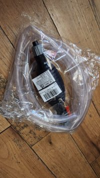

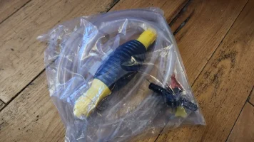

These arrived yesterday..
Looks like both pipes are the same diameter anyway.
Once the tanks arrive I'll give it a go..
These just arrived......
Let the drainage begin.

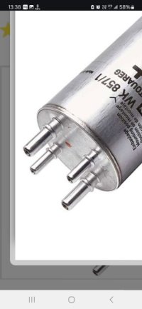

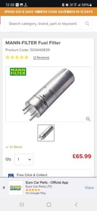

Another way you could do it, is disconnect the supply pipe to the fuel filter, and connect a hose to it, and run it into a can, then run the VCDS fuel line priming feature, and simply pump it out while you have a cup of tea or a beer or 2!
Assuming you have VCDS.
Have vcds, and can run the lift pumps
And have the container and some 10/15mm pipe.
But what id need is a pipe adapter to go from my pipe to the van side fuel filter line....
Some sort of cone shape adapter?.
Or is there a actual proper clip thing that clips into the fuel line to prevent the pipe from popping off?
Just remove the outlet from the filter and if your hose is a good fit, just push it on. Bit loose? pop on a jubilee clip
So we saying, output side of fuel filter....... Add drain hose down to bucket thing..
Then run lift pump.
