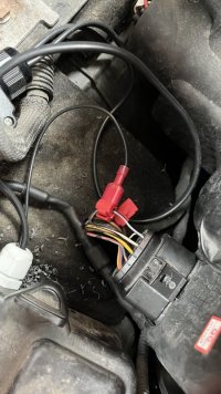

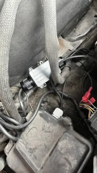

I’m fairly sure wire taps don’t have any IP rating and the engine compartment is exposed to salt spray in the winter.
You could end up with a corroded conductors on the headlamp circuit and all the grief that comes with it.
I do have the under tray fitted which helps a lot with spray etc (also works to reduce road noise as well as an added bonus) but yes, good point. They‘re definitely not IP rated. I used that particular connector type as it incorporates a spade connector so if I’d had to change the pick up point I could just pull the spade out and refit to another connector. Although they do the job I’m not a big fan of this type of connector especially on small diameter cable as they can cut through the wire strands. If everything works out ok I’ll remove them and solder/heat shrink as I have done with other connections in the circuit.

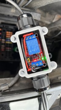

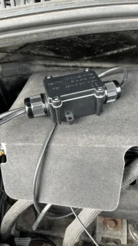

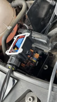

Same process as the front using a relay. I came across the same problem with the voltage - using any 12v+ that comes through any control module, once the ignition is on the voltage drops and won’t power the light strip (or maybe more specifically the drivers to fire the lighting sequence?). I tried the 12v+ on the rear lighting and also the rear internal courtesy light, both worked fine until the van was started with the voltage dropping slightly below 11v. I can’t explain why this is happening so any feedback from anybody else testing at these points would be useful just in case I’ve got a potential fault developing. In the end I’ve picked up a 12v+ from the LB circuit in the rear of the van which switches through the relay.
