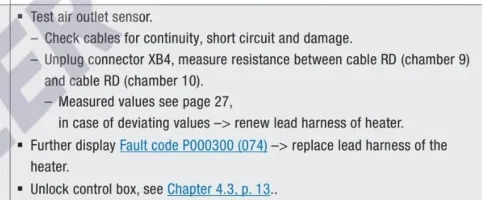

Eberspacher Diesel Heater (which was working fine). Now throws up a fault code on the controller of P000300. Attached is an image from the troubleshooting manual.

Now the troubleshooting guide seems to suggest, that the loom / harness is most likely, in this case, maybe more so, as clearing the fault codes to 'unlock the control box' has no effect.
The temperature sensors on the control unit, and the air sensor both work and read correctly (as can be viewed on the display of the control panel).
So before we bite the bullet and order a new loom, any thoughts?
