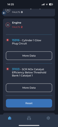

My engine warning light came on and so I got myself a Carista and a free month trial to try and see if it’s something I can sort myself

For code 31103 check out the below thread - apparently nothing too bad. Please post contents of ”Detailed ECU info" -report (under CaristaService menu)” - there has been an engine software update that should make these faults less frequent.

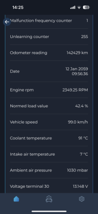

As for the glow plug fault 15916 I believe the malfunction frequency counter will go up if the fault is reoccurring. So, you could just keep an eye on the counter to see if the fault persists. Or, just reset the codes and see if they come back.
If the glow plug fault seems to persist you might want to get it checked - could be a faulty plug or wiring. The van will start and run with three plugs but not as well it’s supposed to.
Thank you! Will read the other thread
So I cleared both faults after a stint on the motorway. Restarted the engine and the light hasnt come back on!
