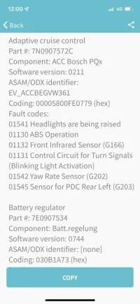

I saw my soot level at 12.9 somewhere but damned if i can find it again. How do I find it again?
This is the only thing bothering me on the ECU check cos I have no idea what it is telling me. But my adaptive did fail for a couple of days and then come back. Lights are set travel i'll put them back to UK when I next drive it. None of them fault codes are showing.
Please post "Detailed ECU info"-report (under Carista Service menu)
I believe Carista misleadingly associates the fault codes. Another proposal for decoding the faults here:
Probably the one that eventually needs attention is:
1541 - Sensor for Automatic Distance Regulation; Incorrectly Positioned - C1103 00 [008] - - - [FAULT_MISALIGNMENT_VERTICAL]
03303 - not necessarily a fault
There only some errors under adaptive cruise control. No idea what it all means but she is running great.

Fault codes:
01541 Headlights are being raised
01130 ABS Operation
01132 Front Infrared Sensor (G166)
01131 Control Circuit for Turn Signals (Blinking Light Activation)
01542 Yaw Rate Sensor (G202)
01545 Sensor for PDC Rear Left (G203)
My interpretation of the codes by removing the leading zeros - which I believe are padded by Carista - would be the following:
1130 - Sensor for Automatic Distance Control - C110B F0 [008] - Limited Visibility - [FAULT_SENSOR_NO_FREE_SIGHT]​
1131 - Sensor for Automatic Distance Control - C110B F0 [008] - Limited Visibility - [FAULT_SYSTEM_NO_FREE_SIGHT]​
1132 - Sensor for Automatic Distance Control -C110B F0 [008] - Limited Visibility - [FAULT_SYSTEM_DISTURBED]​
1542 - Sensor for Automatic Distance Control - C110B F0 [008] - Limited Visibility - [FAULT_SENSOR_BLIND]​
1545 - Sensor for Automatic Distance Control - C110B F0 [008] - Limited Visibility - [FAULT_SYSTEM_BLIND]​
Most likely the one that eventually needs attention is:
1541 - Sensor for Automatic Distance Regulation; Incorrectly Positioned​
the others are either consequences of the "1541" or separate incidents.
As there is lot more associated data with the fault codes for a proper analysis a full fault code readout is needed, e.g like this data captured in
Intermittent - Confirmed - Tested Since Memory Clear
Freeze Frame:
Fault Status: 00000001
Fault Priority: 4
Fault Frequency: 1
Reset counter: 207
Mileage: 60514 km
Date: 2021.11.09
Time: 18:32:35
Control Module temperature: 22 °C
Voltage terminal 15: 14.4 V
Vehicle speed: 14.43 m/s
Acceleration: 1.19 m/s²
You certainly could just clear the faults and see what comes comes back.
