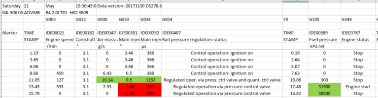

i got this log file but i could not open it?
does it help you guys?
  • log startup.csv

Nothing obvious in the log yet - green are good: injection started, fuel pressure was correct
However - for some reason the injection then had ceased (red).
Unfortunately your old interface is very slow for a proper recording - see time stamps in left column - recorded events are approx. 2.4 seconds apart which makes very difficult to see actual timeline of events.
