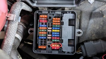

Blown fuse was No13, located under bonnet on right side of bay, one up from bottom on right side, 5 amp. He did tell me what fuse was specifically for but I didn't make a note of it
Could have just been a 'glitch in the matrix' but hopefully it'll be the one and only time it occurs
