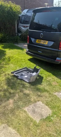

That’s interesting. Few questions if you don’t mind…
1. How did you gut the pre-cat?
2. How do you know that’s enough of a change for more power vs custom downpipe? Any other examples?
3. Do you expect it to be louder?
Thanks for sharing pictures
1. Pain in the arse to remove but do-able on the driveway if you're handy with the spanners.
2. Only from what I've been reading up on and from other people's experience and Maf flow readings of gutted pre-cats Vs custom downpipes.
The existing downpipe is 3" inlet down to 2.75" exit so fairly substantial which will easily flow 400bhp.
3. I've been out for a quick test spin, not really noticeably louder in the van but mine is fully insulated, bit deeper note on tickover as effectively you've removed a small silencer as the pre cat will have a silencing effect on the system.
Certainly no drone inside.
Van seems to pick up noticeably better at lower rpm, I also noted my MAF reading on peak power on my local drag strip peaked at 230g/s whereas before I never saw more than 225g/s

Yeah I might get round to taking that off at some point, I was running out of light and time to get it all back together, the last pic of it back together is surprisingly dark, guess that's modern phone camera tech for you
I fitted the pipes first on ours and then carefully had the wife feed them through as I manoeuvred the cooler into place ..
But ours has the old crappy pipes that clip into place so I didn't wanna run the risk of trapping the new seals fitting them with the cooler in situ.
