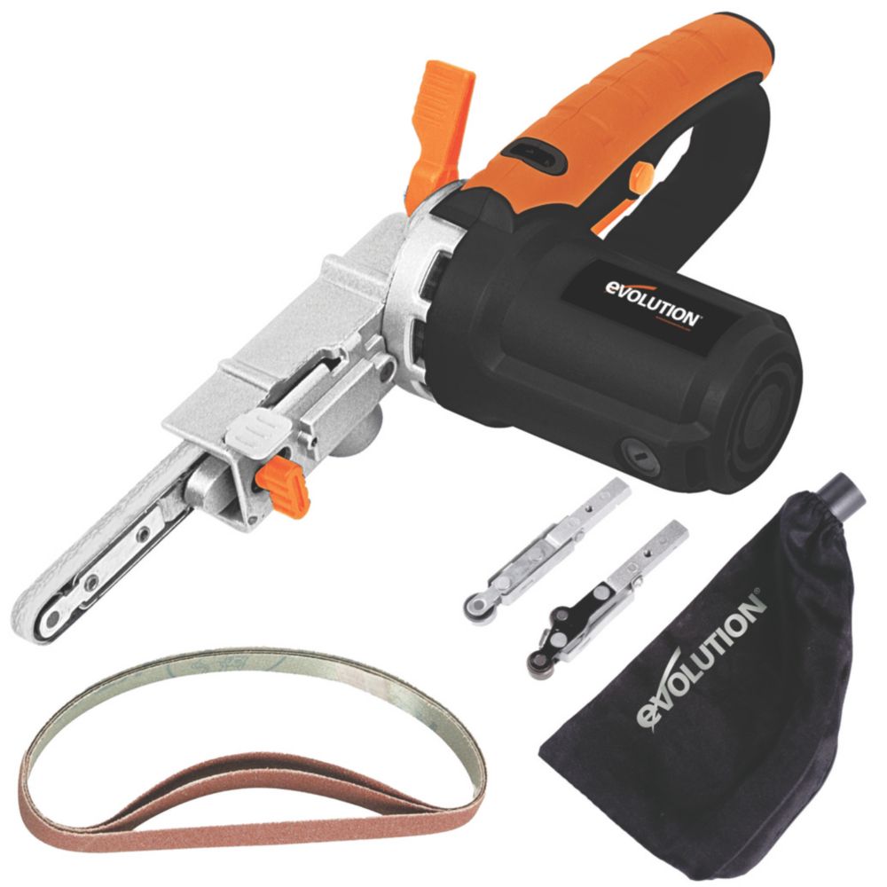

I’ve found one of these good for grinding without causing too much mess and minimal sparks.
