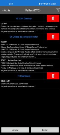

From where the "sensor A failure" interpretation comes - it's not on the screenshot. I believe the interpretation is not correct.
According to VW TSB/TPI fault code P046C alone and no emission light on dash means no repair needed.
Please untick the "Use Aggressive Mode" - does the fault disappear?
Hi, thank you for you answer. Sensor A was specified to me by the car scanner obd bluetooth. He copied it exactly now.

I have also had this EGR 15560 sensor 1 and 23871 error coming up on the van when driving,I am able co clear the error but still comes back up now and again.
I have put the photos of the scan on ,any ideas folks ?
John
Would be helpful if you could do VCDS Auto-Scan (use Auto-detect), save it to file, then attach the file in your post.
Anyways, 02256 - Quiescent Current. Indicates that there are extra electric consumers connected which draw (too much) current when the van is locked - e.g. USB chargers, etc.
Could also use VCDS to run quiescent current test.
23871 - aka P0401 - EGR System Insufficient flow.
Please run engine's EGR flow test.
15560 - aka P046C - EGR Sensor 1
Please run engine's EGR Valve Self Test
