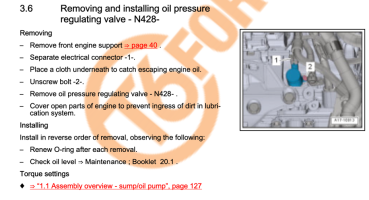

Plugging in Carista reveals 16056 fault code, which after googling, seems to relate to an oil pressure sensor.
Hoping to rule out some quick fixes before taking to a garage, I've replaced the brown High pressure oil pressure sensor. But the code returned after clearing. So thinking the low pressure (green?) sensor would be next on the list? Can any tell / show me where this is as struggling to locate it? And are there any other things to consider trying?

Morning Richie, just wondering how you got on with your problem ? I've developed the same issues ( stop/start , oil pressure sensor code) I've had the battery on charge which seems to solve the stop/start and changed the front pressure sensor but still getting the error code and flashing coil warning!!! I've decided to change the 2nd Oil sensor at the back of the engine but as you said I can't find it either so any guidance as to where it is would be appreciated.

The coil light is flashing and the local VW specialist has put it on the computer and identified the fault coming from the oil pressure sensor on the oil pump. They have told me that is in the sump. They have ordered a new sensor to start with from TPS and they said next day delivery. Then they said 10 working days and now 5 weeks later we keep getting told next week.

had sensor replaced. Had sump off and found debris in strainer. Replaced that. Still got same fault said it is a pressure at the oil pump on the sensor. Like I said replaced sensor and checked oil pump no problems found.

garage suggest next step to replace other 2 sensors!

Hi Phil.
Yes. It was a faulty oil pressure switch.
There are 2 apparently and it was the one at front of engine.
No problems since changed.
