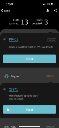

Checked it last week and couldnt see any splits.I had p0401 and 80407 it’s said restricted flow would clear but came bk pending the little actuator arm was seized solid some one plugged it in January time and they was Egr fault them so cleard it been all right till a few weeks ago management light came on cleard but soon as you did 15miles it came bk not dash but said pending done about 100 now on new Egr had no fault codes since have you checked yours for any splits in the pipes

Its a van : 75kW --- I'll type some code down not sure which one I needWhat engine is yours
I did this the other night. Worked well for throttle response and quietness. However, P0401 and 23781 has come back! I’m going to do again as OReillys said stubborn engines need a couple goes. Also EGR return to exhaust manifold is leaking (cracked pipe) so need to replace that tooHey hey,
