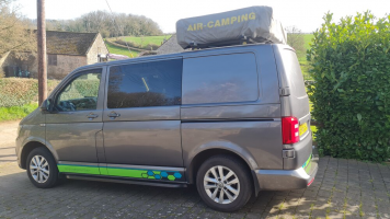

Didn't want a pop top, so opted for a roof tent to provide space for daughter to sleep.
Still enough space up top to carry a 6ft surfboard.

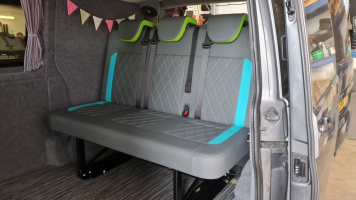

Decided to go for a full width rock and roll bed. After much research purchased one from Titan Beds. They fitted it too. Long waiting list though.
Daughter loves the back seat. Any long journey and she is there. Travels up front rarely now.
The front 2+1 seat set up is OK, but can be a tight squeeze.

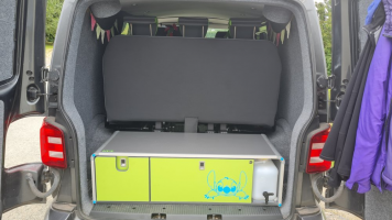

Kitchen duties are sorted by using an EVO Designs Rear Pod 2C behind the seat.
