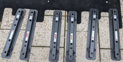

I have some Transit custom rear seats I am hoping to fit this week.
If someone has already fitted these, on the runners the middle pair are pretty obvious, but the near side and offside....Which is which ?
The only obvious differences I can see is the 2 holes on the side lip and the position of the " nipple ". Does the nipple go at the rear or the front ?
Having said about the middle ones being obvious...again there are 2 holes on the lip of each runner, should these face in together away from each other, to the near side, off side ?
Any advice much appreciated :)
Thanks
Andy
Andy,
I presume you figured it out ages ago, but in case someone else is about to do it, I spent a while looking at them (mine have just been delivered) trying to figure it out myself. I'm pretty sure the stickers with dots are the key - 6 dots are the 6 rail positions, with the 2 coloured in dots being positions the rail could go in. On mine (row 3 seats) there were 3 identical rails, that could go in position 2, 3, 4. The holes on the side lip match a locating pin on the seat - on mine the n/s and o/s have the pins (and holes) on opposite sides.
Hope this helps someone else,
James
