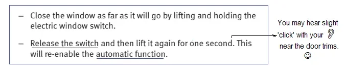

Relearning auto-roll up function of your door windows should fix your issue.
Next step would need to be to switch away from key button holding to one touch button press for mirror folding.
Huh? Can you explain this in detail please
