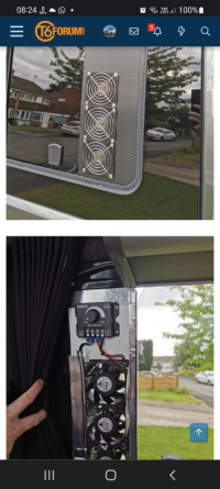

Hickey's fan unit looks good, and certainly a variation on the theme I'm aiming for. but I suspect the small fans might make a fair amount of noise?

I've now knocked together a working prototype. I'll try it out on a few camping trips before making any real changes to the design. I think it will work well, so any changes I make to the next version will most likely just be cosmetic. It certainly shifts a fair amount of air. In a very unscientific test, it will fill a large bin liner with air in a few seconds at full speed, and in a couple of minutes at low speed. Noise levels. it is fairly quiet even at full speed, and is completely inaudible at the lowest speed.
I've added some photos. I'm happy to provide more details if this project is of any interest to anyone other than myself
