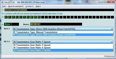

I may have a go at coding before buying a gearbox
Definitely makes sense to have a look into coding possibilities before buying a gearbox. The Euro5 and Euro6 engines are implemented quite differently softwarewise. Probably one main reasons behind that is that their ECU's are from different manufacturers.
Maybe the engine coding might conflict the instrument coding - Is there anything in the instrument module that might cause the coding issues?
Good question - need to have another look... Anyways, in the adaptations nothing obvious there. Probably makes sense also to compare module 17-Instruments software versions (below H03 1107) and codings of a van with 5-speed gearbox and a van with 6-speed.

Yep, good idea. Here are the engine and instrument info from a 2016 Euro 5 102 5 speed:
Address 01: Engine (J623-CAAB) Labels: 03L-906-022-CAA.clb
Part No SW: 03L 906 019 GE HW: 03L 907 309 L
Component: R4 2,0L EDC H38 6292
Revision: 22H38--- Serial number: 00000000000000
Coding: 01114012232401080000​
Address 17: Instruments (J285) Labels: 5K0-920-xxx-17.clb
Part No SW: 7E0 920 970 L HW: 7E0 920 970 L
Component: KOMBI H05 1008
Coding: 470B010100
