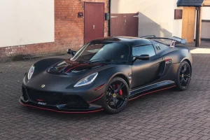

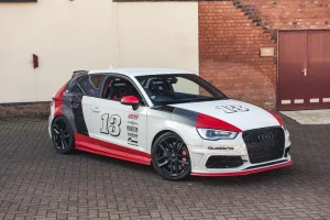

Currently have these 2 beauties for sale if Track days are your tipple . With the S3 I chased a Lamborghini Performante around SPA Francochamp and caught it surprisingly quickly . Yes we drove it to Spa and back and yes it runs Bilstein B16 dampers Sadly the KONI Track day dampers are £3500.00 and client needed a lot of things from a tight budget so B 16 made sense . 385 HP is more than enough with 4x4 traction , The Lotus is a beast no electronics and V6 supercharged rear wheel drive , Dont blink for too long .
