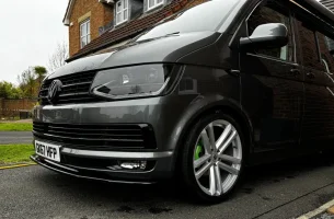

I’ve changed my front bumper to gloss black trims and I cannot for the life of me get the gloss black badge to clip in.
I’ve tried it with the bumper on and off as well as having the grill detached. Still with no luck. I have broken the little trim clips on 3 badges now.
I have ordered a new one which will be here tomorrow but I’m hoping someone might have some pointers as I cannot keep going through badges!
Thanks in advance
My Travelin-Lite badge is the same. Brute force and pure ignorance seems to have been the answer for me, so I’ll be keen to read how anyone else resolves it!
Yeah that’s where my badge is from
(Not the grille) My matte one that was used on my standard grill was perfect. I’ve from there again so lets see how this one goes. I’ve got a different grille coming as well so hopefully this will do the trick.
I’m trying to avoid bonding it on if I can.
I bought both the gloss grill and badges from travelinlite. They didn't fit until I enlarged the holes with a sharp blade. Now fits neatly. Easier if you put the badge on the grill first. As you can see from behind which ones don't line up properly
So did you just use a stanley knife to make the outside 2 slots of the slotted sections slightly bigger? (If that makes sense)
Well got sorted in the end. Still couldn’t get it to fit fully into the grille despite trying to enlarge the holes. I ended up bonding it on to fully secure it. Not ideal but I needed the bumper back on. Happy with the overall result, would I do it again? Probably not. I’m just not keen on the aftermarket parts. I may still go down the route of painting my genuine grille. I added the Maxton splitter while the bumper was off.IMG_0904.jpegIMG_0903.jpeg
