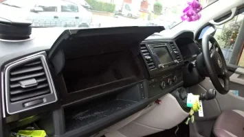

I got this far with the usb, just need my van back to plug them into
@Pauly ,the bigger USB in the photo ,is this the one for glove box ?
The standard van one is a different shape and won't fit in the glove box .
Have you managed to source a lead for power to USB splitter or do you think you will still have to swop pins over to the red connector.
I have purchased a USB power convertor, and wired up the USB port in the glovebox and the tray next to gearstick. All work for charging.
I really want to have both usbs working with app connect ,and car net ,so will need to go genuine vw .
Thats correct one large and one small for glovebox and centre console, i havent tried anything else with it yet as havent/dont have the time
Havent made any progress in terms of power source as discussed before it looks like all that is required is the 5V + and - need to be taken from the dash socket and connected to the usb hub along with a 12V supply which can come directly from lower fusebox or other place if easier and connected into the red plug
Managed to get the genuine vw USB splitter and both USB,s fitted with the help from @Pauly .Not a bad job to do ,two cables to remove out of the existing dash USB socket and a new 12volt feed to get to the splitter ,I used a piggyback fuse and fitted it in a spare fuse holder .
All works with app connect .
Also got some vcds tweeks done ,so happy days ,big thanks to @Pauly for the USB help and @Nickdaw for the vcds weeks
View attachment 3943 View attachment 3944 View attachment 3945
@amdowney this is the USB"s I put in

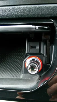

Am I right in thinking if I just wanted to move the USB port from the dash pocket to the centre console pocket I could just buy the smaller socket and use the original wire??
Like this..... (apologies for the awful photoshop skills)
