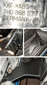

This is the part you need to remove to get the lower roller out.

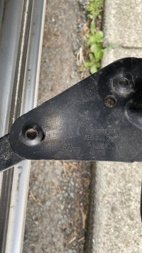

2. Undo the two torx bolts on the lower bracket noting the position in the slots for later:
