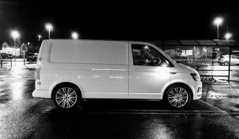

This is what I'm hoping they might look like on a van:
