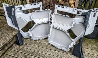

This thread will chronicle my journey of transformation of these two tone door cards.
I bought these two cards on a whim to see if I could improve the cabin feel, from workman to luxury(ISH)
