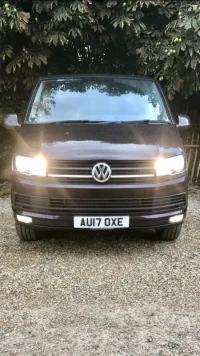

The comparison:
^H4 on top H7 Below, Showing DRL's^
^H4 on top H7 Below, Dipped Beam^
^H4 on Top H7m Below, Full Beam^ The beams looks very narrow here in the photo, in reality there is illumination to the sides, enough for the human eye to see hedges,driveways etc, but not enough for the camera to pick up. It does however dememnstate that the H7 have a far better 'throw' and do allow you do see further afield.
Both lights were fitted with the correct fitment Osram Night Breakers and have thrown up no errors.
Conclusion:
Hopefully these make a good comparison, But please note these were recorded on a nextbase dash cam and are screen shots from a downloaded video. The H7 are a much better light and put you where I believe a standard headlight should be. I'm much happier with them and they also look better on the van. its a worth while upgrade in my eyes.
