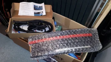

Because of the great price, and as I would have access to them, I decided to get some of the white DRL replacement bulbs, and an uprated set of H7s. I went for just one set on the Dipped only.

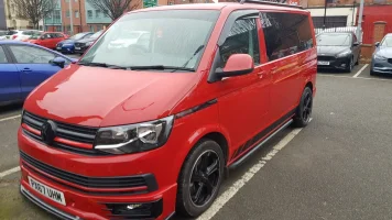

Unfortunately I deleted the picture of 1 white DRL with 1 OEM (yellow) DRL, but they are significantly whiter, a much nicer look.
The Philips H7s also looked a bit better, difficult to tell in the light, but seemed to make a difference.

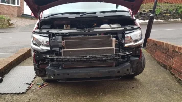

Put it all back together (used the Transporter HQ video, also helps to have removed bumper once before) and only one piece left over! I had a bulb error and I think one DRL was not in correctly, so I fiddled with it, and it came on, but the holder stalk thing came away. But it started raining and got dark, so that is sitting in the van!
Also need to get them coded, so if anyone in Stockport / Greater Manchester could do this for me, beer tokens are waiting
