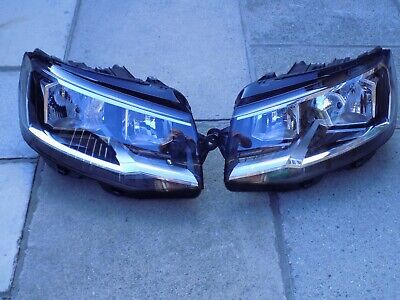

And another, bit pricey at £195 delivered:
Ordered. Not happy with my thq headlights, and have tried so many different bulbs they always feel like a compromise. So for me gonna try these as a last resort. I should make the money back selling the thq headlights anyway.
The 5000K are still a bit too 'blue'. 4300K are as close to OEM xenon and the best for light output.
Sorry its a 55w, so should be 4300k at output, but still, im not a fan of the cut off of the projectors, or the indicator brightness.

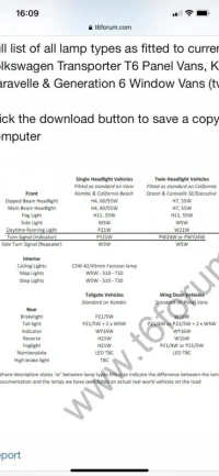

Having a mare here, what bulbs are needed for the indicators on these h7 headlights? the seller had removed both and thats the only thing i didnt chcek before refitting the bumper
Awesome! I ordered the bulbs just before you'd posted, and had to get them from vw. Next thing is alignment.
