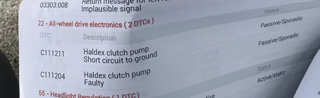

I bought a 17 plate t6 204ps and when I did a scan on my Carista it said haldex pump failure
Sure enough only front wheel slippage on test coming out of my local slipway with the boat on.
I Ordered a new pump & fitted it yesterday, when I did the calibration (it whined up as its should) and then all 4 wheels were spinning under test.
Today when I scanned the van I’m getting the same haldex pump failure fault and when I tried to re calibrate it the whining was really Intermittent (like it was trying and failing to run) and the calibration failed.
Having looked through the service history it already had a new pump 3 months & 3k ago.. so I’m guessing that a faulty pump isn’t the issue but something else?
Any advice on what it could be?
