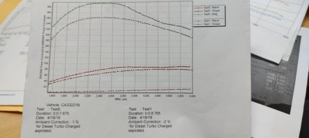

Before:
93.8kW @ 3383 rpm, 256Nm @3182 rpm, which is already 13kw and 6Nm more than advertised. It goes well in stock form.
So I sent it for the remap and dyno with a reputable firm. Koos is from a racing family and has 40 years experience in tuning.
After - holy cow!
146kW @3471rpm, 434Nm @2375rpm, with torque peaking at 2200-2600rpm.
The T6.1 went like a rocket! One could see north of 160km/h or 100 mph in a jiffy. I never tried, but one would most probably be able to run 4000+rpm in 5th. "I have to upgrade the brake system" was the first thought. BUT the gearbox did not like it. From 2500rpm on the gearbox did not complain, but anything under 2500rpm one could induce a judder through the drivetrain at will. It feels like the whole car is shaking. You can feel it through the steering wheel and your pants. The issue here is the sharp bump in torque at low rpm on the map above.
PS. A friend has the 146kW 8 seater 4 motion with 7 speed DSG, and once can feel the same shudder at low rpm there. It is not as pronounced as on the 5 spd manual, and of course the DSG box immediately jumps to a lower gear and higher rpm when instigated to mitigate the issue.
Koos says that this 2.0TDI engine is severely detuned. Audis that have this same 2l diesel comes in 130kW standard tune, so for the engine to make so much power is not an issue. It will not damage the gearbox he thinks, but the clutch might start slipping if induced.
So I had to go back to the tuning shop. "Please detune the engine to take care of the terrible shudder" I asked. So they did detune the engine.
After: 121kW @ 3258 rpm, 364.2Nm @ 2766 rpm. (see the lower values on the sheet above).
The bus wasn't as fast anymore, but still much nippier than stock. After proper testing the vibration issue prevailed. In 3rd gear I could induce the vibrations from 1600-2200rpm, whereafter the vibrations disappeared. The issue was that 300Nm was already produced at 1800 rpm, with 340Nm at 2000 rpm (was 380Nm @ 2000rpm) and a torque peak of 340+Nm from 2000-3200rpm, peaking at 364Nm (434Nm on the first map).
So I had to go back a third time.

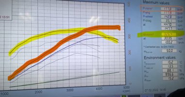

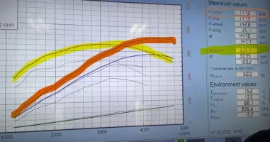

Pendle Performance's video helped me a lot to understand what needs to happen. The essence is that there needs to be a smooth torque curve, with not more than 300Nm @ 2000rpm. His successful tune peaks torque at 326Nm @ 3000rpm. Check out his tune here:
Koos did his magic, and came up with the following:
122.9kW @ 4123RPM, rising steadily from 60kW @ 2000rpm
He kept the Torque under 300Nm, with 260Nm @ 2000rpm, 280Nm 2 2500 rpm and 295Nm @ 3500 Nm. What he basically did was to keep the 2nd map but flatten the curve between 1500-3500Nm. The shudder at low rpm is now gone.
Looking at the graphs, the holy grail for the 5spd gearbox is <300Nm @ 2000rpm. The previous T6 was happy with 300Nm @ 200rpm, and a max of 315Nm from 2200 rpm onwards.
So there you have it. The holy grail of the 5spd gearbox on the 2L TDI is to keep torque below 300Nm under 2000rpm. The secret is a smooth torque curve, rather than too much torque at low rpm. I might want to go back and ask for 325Nm @ 3000 rpm as Pendle has proven it safe, but the Transporter goes well, and I don't think it will damage the 5spd gearbox.

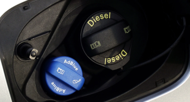

Just curious if the 2024 T6.1 in question has AdBlue system?
Different engines for different market/emission territories.
I had to educate myself on Adblue first I don't have an Adblue filler on the vehicle, and have never added this to the vehicle.
On inspection the Adblue filler cap on this T6.1 has been blocked off, so no. No Adblue.
I see that Adblue has to be replenished: If you’re wondering how long AdBlue® lasts and how much you should use in your vehicle, the rate at which your AdBlue® depletes is around 1 litre for every 350 to 600 miles. The exact rate at which you should top up your AdBlue® depends on your vehicle’s engine size, your driving style, and the size of the vehicle’s AdBlue® tank, which varies between 5 and 20 litres in size.
