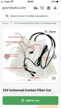

Got a link to the original heated seat kit?
Yep . . .
But for anyone that's interested in adding an aftermarket heated seat kit.
A link would help.... (Plus interested in seeing the kit myself, I'd like to see what the heat pads look like)
I got it about 3 years ago and just came across it on Sunday but unfortunately it was just in a brown box and I haven’t got the instructions make or model hence all the questions about fitting it.
