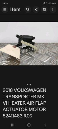

hello again. I've taken bottom part of dash off and found the fault, woohoo. it's this black n white link. as picture. I can move it by hand n back to being toasty again. doesn't move with controls, so leaving it with heat due to miserable weather. im thinking motor or something. thanks again for the tips. russ

hi Stuart. yes you pull off the panel above Yr pedals. grab a torch and it's located up towards the radio. you hopefully will be able to move the black linkage arm, up and down. that should allow heat through to drivers side. Good luck

Managed to push some bits which looked like the photo til the air came out warm.. doubt it will stay like that very long! What a squeeze that is to get to! Do you need to take the whole thing out to fix it properly?
