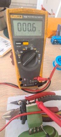

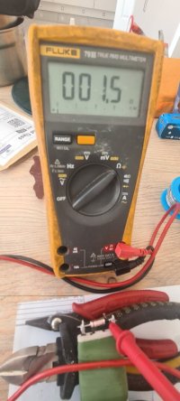

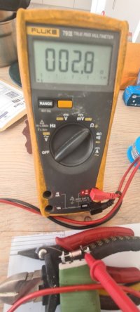

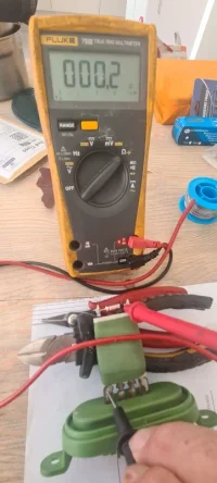

I measured the resistors across from pointed end of fuse to pin3,2, and 1= Good resistor readings.

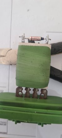

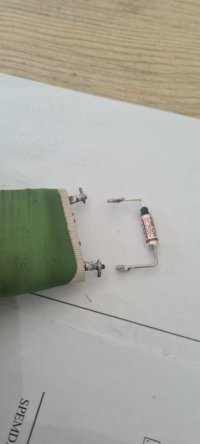

Measuring across the thermal fuse is open circuit. Will try a new fuse from ebay for about £2. I believe its a 192 degree unit at 15amp.

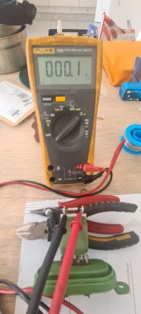

ok guys, got the thermal fuse from interner for a couple quid. fitted and working fine. As suggested i used pliers as a heatsink so the fuse didnt melt while soldering. So snipped off old fuse, gently filed to fresh copper on both studs, tinned the studs, tinned the new fuse- holding with pliers- soldered fuse in place again holding with pliers. Tested the fuse each time i used heat on it. Jobs done and working fine. I measured each resistor= all good. hopefully all pics will load showing my sequence. Again hoping to help others save a buck or 2.
