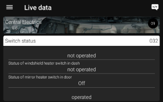

Does the switch talk to you?
Please verify the switch at OBDeleven > Control units > 09-Central electrics > Live data > Channel 032 > Value 3
What's the value? Should changing between Off/ON when the switch is operated.
