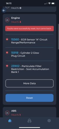

As the thread suggests, I’ve got the coil light and Engine management lights on - so in limp mode. Carista is stating 60grams of soot and won’t perform a forced regen. These are the faults showing:
I have removed the DPF from the vehicle and used wynns off the car DPF cleaner, reinstalled to the van and I’ve still got the same issues/codes.
The codes also reappear immediately when cleared without the engine running. Does this suggest a sensor issue?!
Please help!!
T6 2017 150bhp engine.
Andy

23902 - Particle Filter
P2463 00 [10100011] - Excessive Soot Accumulation
MIL ON - Not Confirmed - Tested Since Memory Clear
Freeze Frame:
Fault Priority: 2
Fault Frequency: 1
Mileage: 79049 km
Date: 2063.01.15
Time: 13:28:22
Engine RPM: 0.00 /min
Normed load value: 0.0 %
Vehicle speed: 0 km/h
Coolant temperature: 33 C
Intake air temperature: 16 C
Ambient air pressure: 960 mbar
Voltage terminal 30: 12.273 V
Unlearning counter according OBD: 40
Counter for regeneration time of particulate filter: 0 s
Particle filter: kilometers since last regeneration: 35.7
Particle filter: soot mass measured: -1.98 g
Particle filter: soot mass calculated: 40.18 g
Particl.filt.: differential pressur.sensor 1 bank 1: dyn.offset: 1.5 mbar
Particle filter: field regeneration lock status: 8
