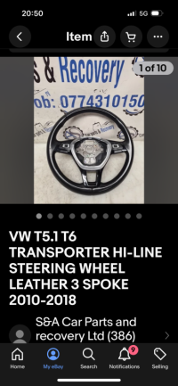

I’m beginning to wonder if this is what the problem is.
This was the listing which suggests it might be an earlier model.

EBay seller has got back and confirmed it was off a 68 plate.
So at least I’ve ruled wrong buttons out.
