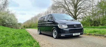

SoLows at their highest and those 17” banded steels that @Tourershine is/was selling would look spot on!How low are they at there highest setting? Heard nothing but good things about solow suspension
SoLows at their highest and those 17” banded steels that @Tourershine is/was selling would look spot on!![]()

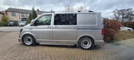

I’ll be honest mate I haven’t a clue I’m happy to measure for you tomorrowHow low are they at there highest setting? Heard nothing but good things about solow suspension
CheersI’ll be honest mate I haven’t a clue I’m happy to measure for you tomorrow
Looking good....cheers for the infoHighest setting at the front 350mm
Rear 10mm down 360mm
Pretty much empty just a flatout bed in the back.
Hope that helps
