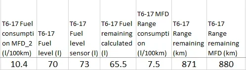

2. how can it be that I usually fill up 77 litres just shortly after it asks for being filled up (80l fuel tank, obviously) and still says I have 100 km range? This would suggest more like a 90 l tank which doesn't exist.
Well, the 80l (or 70l) is just the nominal capacity - the actual capacity is a different story. On the Forum there are posts about brave people having driven well beyond zero range on MFD - and managed to put in more than the nominal volume (just can't find a post now).

Well, some other fascinating MFD & fuel consumption features here:

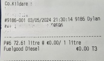

I have a 70l fuel tank and managed to fill up quite a little bit more than 70l 2 days ago.
