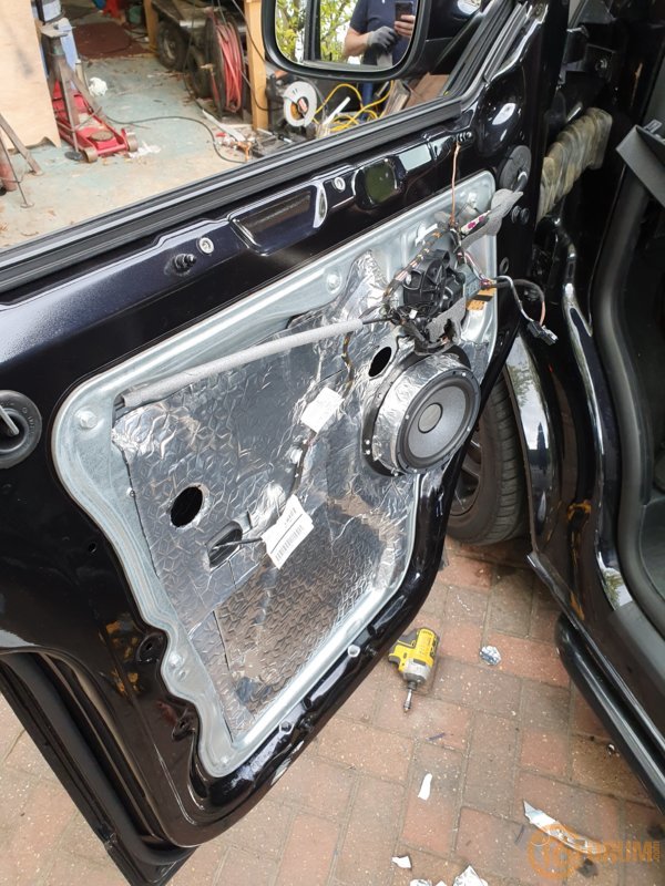

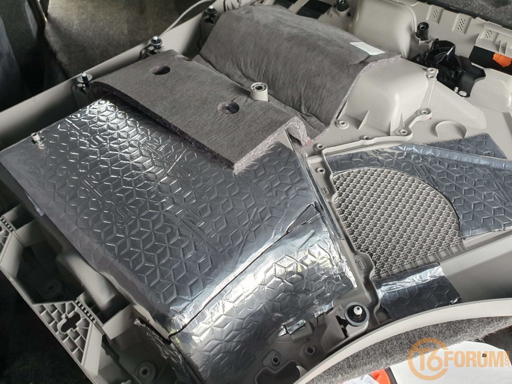

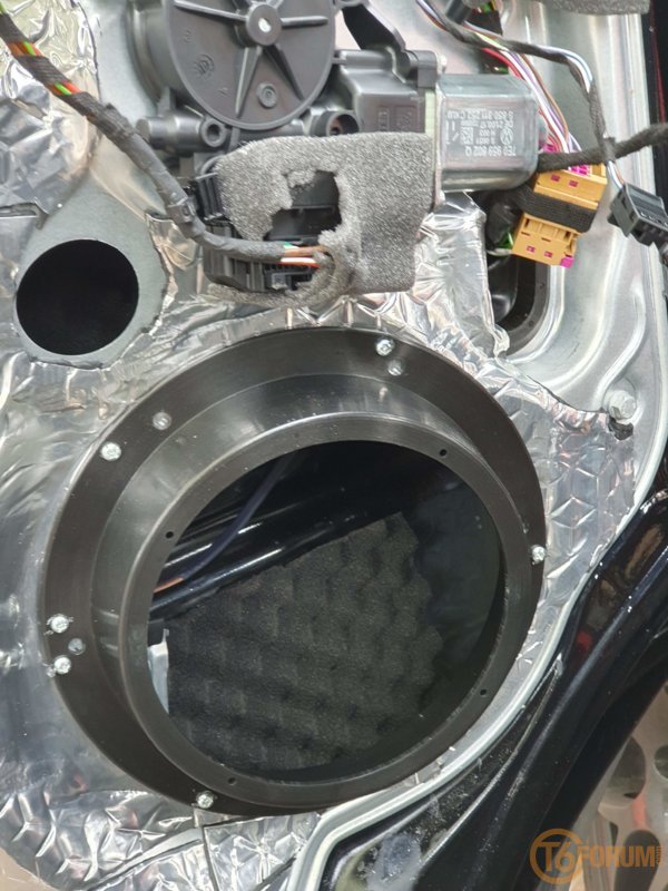

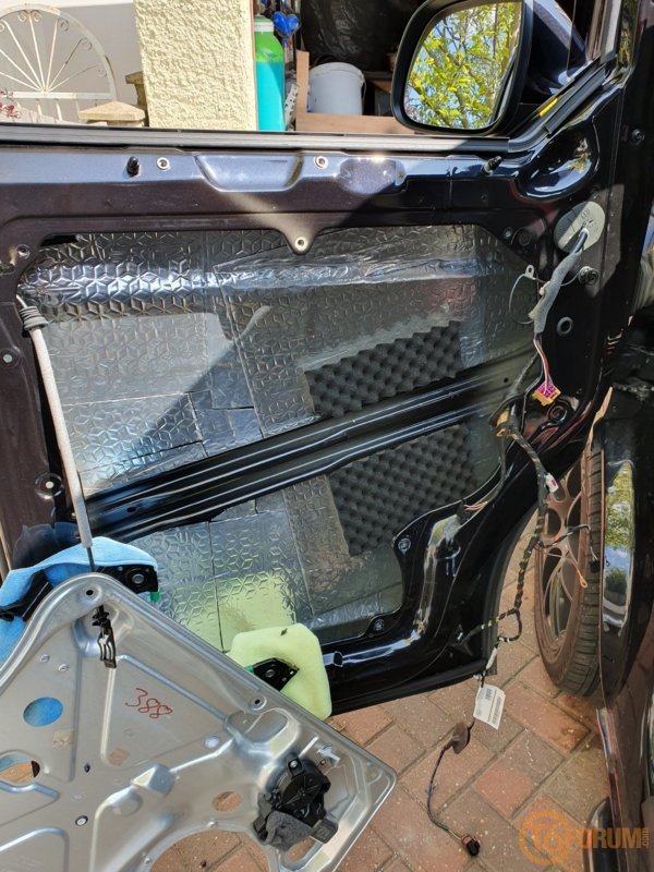

Busy upgrading the standard T6 Audio at the moment.
I've massively upgraded the door sound deadening by adding 15 sheets per door plus foam backing behind the new rainbow speakers which included new tweeker upgrades via crossovers. Also. I've discreetly retro fitted into tmy comfort dash cubby hole, a bass controller dial via a AccuBASS LC2i line-output converter installed behind the glove box.

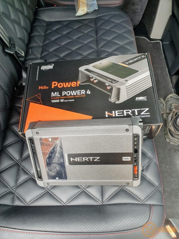

Next job will be to install the new 4 channel Hertz amplifier (under driver seat) and 10" audison sub in a custom resin lined box (under passanger seat).
