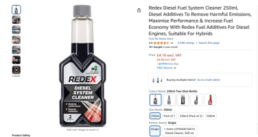

VW gave me a bottle of this stuff when i had a new engine fitted,
then i bought a 4pk of REDEX diesel additive from costco..

The vw garage said use the vw stuff one every 3 months.
And the redex stuff is cheap enough, so I'm using that every tank for the time being.... In both vans.
One redex bottle does 4 tanks worth. So around 1600miles per bottle.
