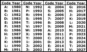

It's my understanding that a 2016 model never had Adblue (UK sales anyway) but 2017 models did have it. You can tell which model year it is by the 10th character of the VIN....
Don't be confused by the eleventh digit as that is most likely to be a 'H' denoting manufactured in the Hanover Volkswagen plant.
So it has a G which means the engine was made in 2016? It's definitely registered in March 2017, definitely a 180bhp sportline and definitely doesn't have adblue.

The 'G' means that the whole vehicle is a 2016 model year production. Nominally produced between 1st August 2015 and 31st July 2016, those dates can vary depending on production requirements.
If you PM @Pauly with your VIN he will provide you with a data sheet(s) showing full details of when and how it was produced.
