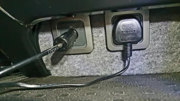

Small update, maybe slightly interesting for other stealth day van nutters. Made this panel earlier, sits under the front of the passenger seat. It's got a din input for the folding solar panels and the socket for the on board ctek 240v battery charger. 20210131_214335.jpg

Just a question on that last photo, the 12v is for charging the battery with your panel, am I correct that the 240 connection also charges it, is that a mod you’ve done to the CTEK? What does the plug go into ? (Is it into the CTEK and the plug is to your mains)

Yep so the 12v din is directly from a 120w folding panel. Normally I just throw it on the dash when the vans not being used and it keeps both batteries topped up, when camping I get it out and get put it on the grass normally, works a treat.
The 240v goes to another ctek which is on the input to the dc ctek. I've got it wired so that it's starter battery priority and then from that the dc ctek will charge up the leisure once the starter battery is topped up.
Hope that makes sense, drop me a PM if you need some help :thumbsup:
