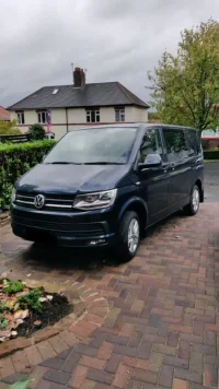

Here's a few pics of it as "Vanilla" Kombi:
