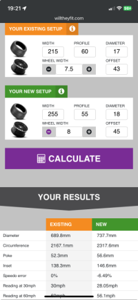

My Speedo seems pretty much spot on with GPS for all of the options which I've tried. (With next to no error between GPS speed and Speedo.) having said this, the speedo under was by about 5% with the factory wheel/tyre setup but I'm yet to come across a setup which causes issues with ACC.

From factory setup to 255/55r18 you get 6.49% difference in rotation:
The question is whether or. It this is enough to throw an error? It isn't in my case.
Reactions: EAN
