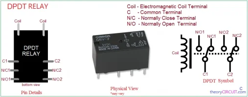

If your van has the standard rear filament lights you would most likely have a rocker switch on the lamp unit and 3 wires in the loom. (0v ground perm, 0v BCM switched, BCM timed +12v perm) The BCM shut off time will be around the 10 - 20 mins mark.
for people looking to have a override switch for say a camper etc then a fused +12v feed wire would be used to feed the lights in addition to the BCM feed. A blocking diode may be needed on that feed wire.
If your switched override feed was coming from the AUX isolated battery feed in conjunction with the BCM feed (from the starter battery) i would defiantly fit a blocking diode to stop any back flow of current from the AUX and STARTer battery.
some people just totaly disregard the BCM +12v feed and just use the new +12v AUX feed, though a warning on this point is that if the lights were left on all night there is a chance of discharging the feed battery to a dangerously low level causing possible damage. . . . . . low voltage cut-out are available to prevent this from happening.
A relay can also be used to shunt the lights from BCM van control over to Leisure battery for extended light on times for camper-van setups and the like.
