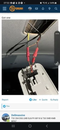

The existing OEM LED light unclipped easily reveling the loom and connectors . . .

next task was cable management, we cut off the small two pin connectors and layed out the cables to roughly where we needed them. We used white gaffer tape to tape down the cables to stop them ratteling etc . . . . we bought the excess cable through the OEM light fitting hole.....we decided to keep the OEM LED lights as dummy units, the also helped out as a good cable way and access panel of sorts to get to the connections . . . .
now the new LEDs were fitted we could refit the panels in the back of the van . . . we pulled the existing loom and original connectors out the hole where the old light was. . . . . .

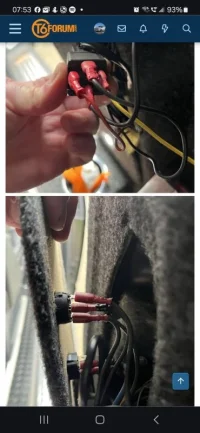

using a multi-meter we measured the BCM 0v ground wire and the BCM timed 12v+ wire (when the rear door was open) and joined them with crimp terminals to the OEM loom . . . leaving the original connector on the end.
