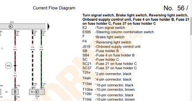

reverse lamps m16 & m17 are connected together in rear wire harness.
they are fed from the J519 (BCM)
the F4 reverse switch (manual GBox) is an input to the BCM,
i suppose the DSG box sends the reverse signal via powertrain CAN bus.
so they will possibly be monitored for "bulb out" warnings. - but appear to be connected together?
