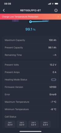

My battery (Fogstar) has a heater and BMS protection, however I’ve added switches to my DC-DC and solar panels to turn of charging when it’s not needed. I did this as I don’t want the battery charging every time I start the van or the sun comes out as that’s not great for lifepo4 unless you are draining it regularly. I don’t, as the van is only used for camping every couple of months or so.
My battery was at -2.5 degrees yesterday but no issues as I had my chargers off.

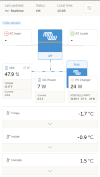

I've left my Fogstar to do it's thing, it's still sub zero inside the van at the moment I but I can see on the Fogstar app the UTC protection is kicking in and the cell temps a few mins ago where at about 4 degrees. I get very little solar this time of year, 25w at most.
My only issue with the system is that the few Ah that the solar has sent to the battery this morning had been used for the heating but the shunt has seen this as battery charge, so the % is now out. But, it'll reset and sync on the next 100% charge so not a big issue.

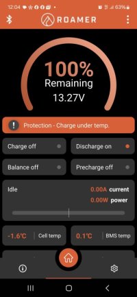

My gen4 roamer low temp has kicked in.
Blocking any charge. As it's now -2.0
The roamer's don't have heaters, do they? But their cold weather versions use a slightly different cell chemistry to allow charging well below zero - clever stuff!

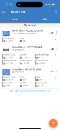

Should it be showing 100%, but it’s just a glitch in the matrix?
no, your battery is 32% charged and needs charging. . .
mines 100% charged.
the voltage will vary from 10-100% but not by much.
The voltages on LiFePO4 between 90 and 20% isn't very different:
But also these are are all resting voltages. Any load or charge current in the last 30 mins will increase or reduce the voltage far more than the difference between 40% and 80%.
