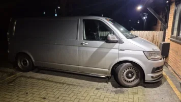

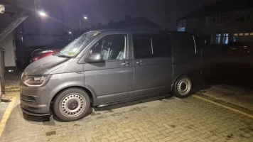

My use case is:
T6 work van.... Gets frozen solid over the weekend.
Then back to work Monday morning, ready to use the inverter etc to charger stuff.
No diesel heater or solar etc etc...... just a frozen van that has a running engine.
So for my van..... I need a heated battery.
Now the bus on the other hand.... That we use for camping, now that's a different story.
We plan to get a derv heater fitted asap.....
My use case is:
Here is the context...
Work van....
And day van / camper.
