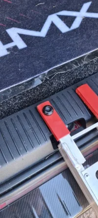

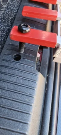

Looks similar to mine, though I used bit of rectangle section tube to make the mounts..
Yep, I saw yours and thought what a good idea. Just thought I`d use what I had kicking around in the workshop, hence the chain hooks.

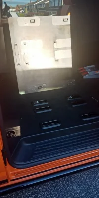

I have 2 identical ramps. Planning on making a way of connecting them together and anchoring on the towbar as well
I have one of these ramps too, but when loading a heavy bike like my BMW 1250 GsA it can twist if the bike starts to go off the edge. I was thinking of buying another and bolting them together. Let me know how it works out.
