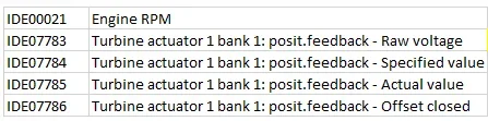

A short version: you could tick the following
under
VCDS > Select > Engine > Adv. Meas. Values
click Save to log them into a log file
both (1) engine off (ignition on) and (2) engine running
These values would give some indication about how turbo actuator performs (fault P00AF).
under

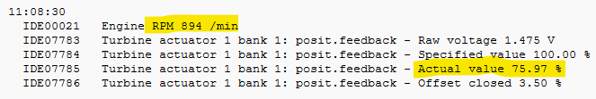

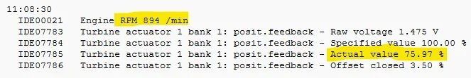

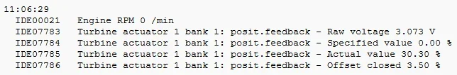

I think these are what you are after my computer desperately needs an upgrade it’s taken all morning to get this off the computer onto my phone
Exactly these.
I think the data confirms that the actuator doesn't move as desired. Besides the actuator itself, of course it could be also the solenoid valve failing or vacuum leak.
On idle I would expect to see specified to be very close to actual value.
Also a bit strange is the RPM, would have expected to see 830 RPM, or sometimes the elevated 970 RPM.
Engine stopped the specified typically is 0% and the actual around 20...25% (for single turbo) so perhaps not too far off.
I think the second sample engine stopped was a bit "corrupted" as it was recorded just seconds after engine was still running thus engine was still in middle of it's shutdown process.
