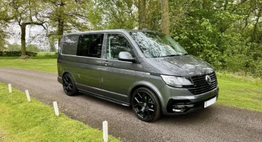

Hi all,
Those of you down around 70mm on 20 inch wheels, would you describe the van looking low, or just right? Having a hard time deciding what I want to go with so any pictures would be great.
I know there are lots of choices and ride height is only part of the decision making process, but seeing how things look at this height might help me pull my finger out and get it done!
Thanks
Hey
I have 20” urban wheels with 275/35 tyres and kw/stx coilovers at their lowest which i think is about 60mm drop
It’s not low, and looks sesnsible / I think to be low and noticeable comapared tothe likes of a v class or you need to be at 80mm which looks good
Hey
